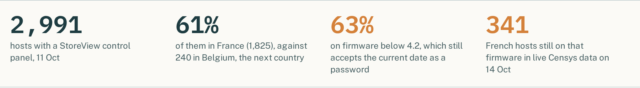

On the night of 11 October, attackers switched hundreds of French supermarket fridges into defrost mode. If that sounds familiar: in August, the Department of Defense confirmed refrigeration disruptions at US military commissaries, where at least one base reported that all its freezers had gone into defrost mode. The Department has not said what caused it or which equipment was involved.
While the August military commissaries hack has no confirmed vendor, the attacks on France do: Danfoss, specifically the Danfoss StoreView product.
We reviewed every Danfoss StoreView control panel Censys found online and identified the version running on each host. Before the attack, 61% of these devices were in France, and most ran a version where the admin password could be derived from the current date.

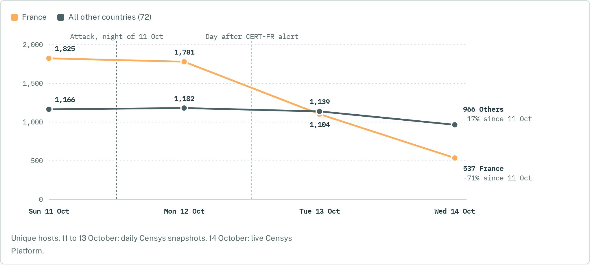

France, Compared to the Rest of the World
The number of StoreView control panels in France went from 1,825 hosts on October 11th to 1,781 on October 12th; in our latest numbers, it fell to 537 on October 14th, 2026.
Elsewhere, the change isn’t as dramatic: the number of hosts started at 1,166 and fell to 966 over the same time period.
This is expected, since most of the damage seems isolated to France or unreported elsewhere.
Below is a graph showing the dramatic decrease in the number of hosts running these Danfoss StoreView controllers in France, and a minimal decrease everywhere else.

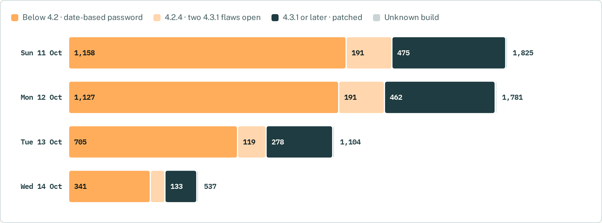

In France, Patched and Unpatched Controllers Disappeared at the Same Rate
What’s interesting is that operators don’t appear to be patching their controllers; they’re simply taking them off the Internet. Patching would have left a mark in the data: the share on 4.3.1 or later (the releases that fix all three CVEs) would have grown in the table below. Instead, every group shrank by roughly the same amount, about 70%. Frankly, this is probably the best choice; there is no reason these should be directly connected to the Internet.

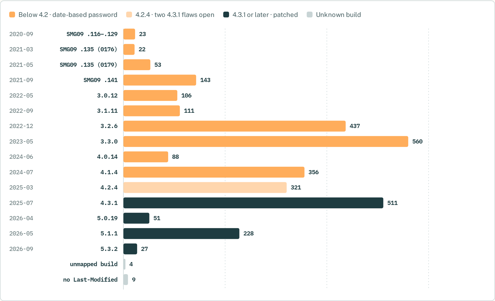

Worldwide, Most Controllers Run Firmware Older than 4.2 (Current is 5.3.2)
The chart below breaks down exposed controllers by firmware version on 11 October, the day of the attack, oldest build first. The three largest groups are 3.3.0 (built May 2023) with 560 hosts, 4.3.1 with 511, and 3.2.6 (December 2022) with 437.

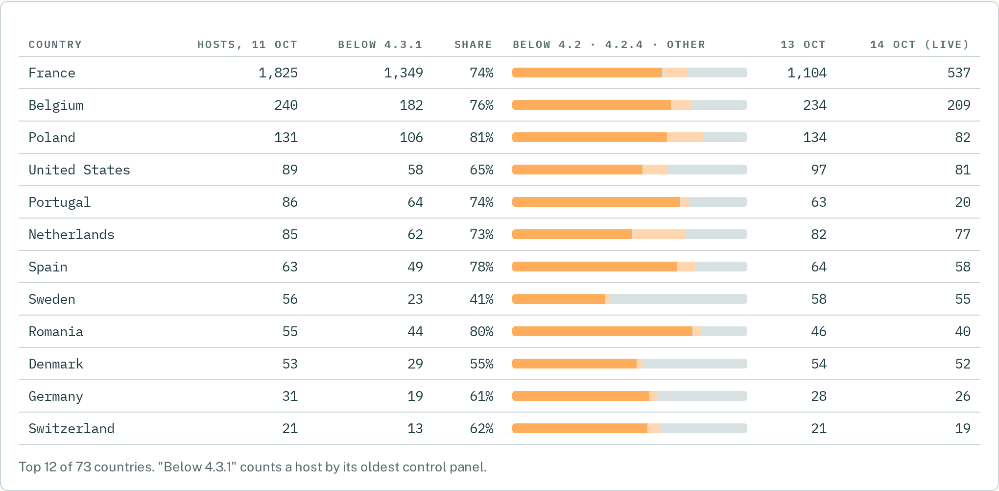

The chart below shows the 12 countries with the most exposed StoreView hosts on October 11th. The orange bars show the share of hosts on firmware below 4.3.1: darker orange is below 4.2 (vulnerable to all three published CVEs (CVE-2025-41450, CVE-2025-41451, CVE-2025-41452)), and lighter orange is version 4.2.4, which fixed the date-based login (CVE-2025-41450) but is still vulnerable to CVE-2025-41451 and CVE-2025-41452. The remaining gray is version 4.3.1 or later, which fixes all three CVEs.
Surprisingly, ten of the twelve countries have more than 60% of their hosts below version 4.3.1, led by Poland at 81% and Romania at 80%.

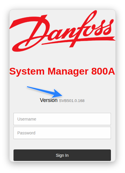

Version Extraction
Unfortunately, the version number on the Danfoss devices’ login screen doesn’t match the version listed in the CVEs; the login-page version seems to be a “web interface” version, not the actual firmware version.
But, as it turns out, we can determine the versions using the Last-Modified HTTP header values, and we verified this with actual Danfoss updates.
