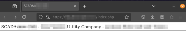

While conducting some routine analysis of ICS hosts using our tool Censeye we came across an interesting certificate running on some web servers that seemed to be running on a bunch of unlabeled hosts that included the word “SCADA”. The term “SCADA” in this certificate caught our attention because it often means “Supervisory Control and Data Acquisition”: a component in larger industrial control systems used for monitoring and administration. And when we visited the HTTP service with that certificate, we were greeted with a very simple message like the one below:
HTTP service displaying the software name, along with information about the owner/operator of the instance.
While there wasn’t much information to go on at first, we were able to collect a few key details: the host was running PHP (index.php), and the web interface appeared to be part of a browser-based HMI system (after searching the internet for the product name).

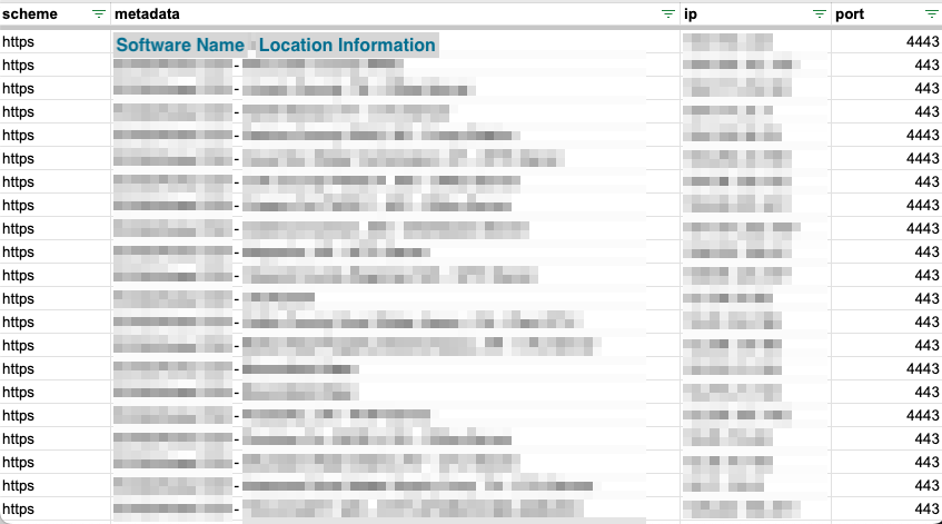

Knowing this, we knew these hosts could be very valuable, even if we didn’t have the full picture. We kicked things off with some general data collection and aggregation. Each of these web servers returned a response body that was similarly structured, typically formatted like “PRODUCT—OWNER—LOCATION.” We wrote a quick script to extract that info into a spreadsheet for further analysis.
Even at this early stage, it was clear we were onto something. Responses like “WTP-Server” and “County Regional WTP” immediately stood out since we recognized “WTP” as shorthand for “Water Treatment Plant”.
Data extracted from hosts with the specific TLS certificate. The “metadata” field represents the HTML title, which contains descriptive information about the location / municipality of the WTP.

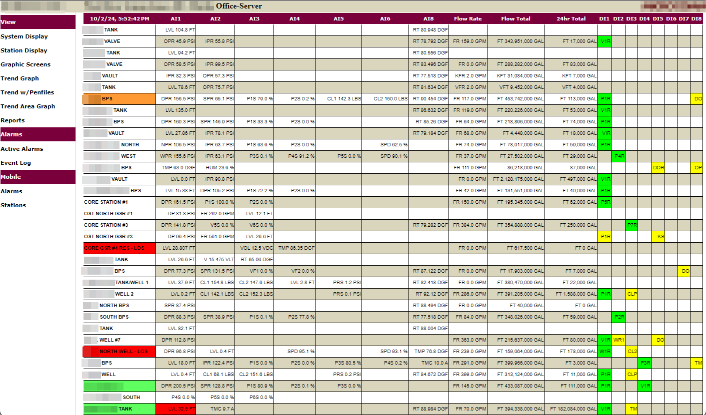

A view of “/System.php,” where we are presented with various monitoring options for the system in question.

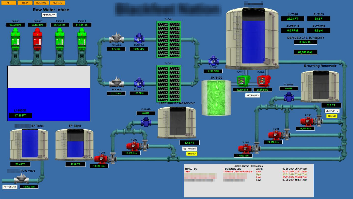

On this status page, we found links for “Controls,” “Set Points,” “Alarms and Monitoring,” and most importantly, a section labeled “Graphic Screens,” which exposed the full HMI for the underlying system.
Example HMI found in the “Graphic Screens” section on “/System.php”.
After pulling down screenshots from every single exposed device, we were met with hundreds of visual confirmations that we were dealing with water treatment facilities all across the United States.

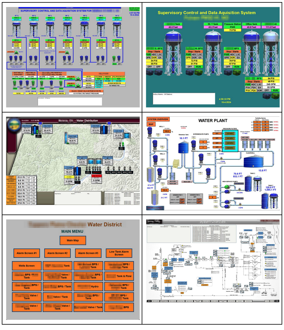

At the time, we found only 95 of the hosts were running with authentication enabled, 264 of which allowed us to read information from the devices, and 40 hosts that had no authentication at all (meaning that hypothetically, we could control the devices connected to the HMI).
Below is a small sample of the different unauthenticated HMI interfaces that we were able to view, from simple menu-based systems to visual controls over an entire county’s water system; A shocking result from such a simple exposure.
Selection of HMI screens we observed, providing insight into operations of various water facilities around the U.S.

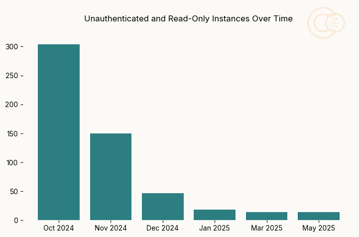

Instead, we relied on a TLS certificate DN containing “SCADA” that led to our initial discovery. We ran ad-hoc scans once per month and then once every two months following our initial scan based not on IP and port, but results of a Censys query for hosts with the specific certificate DN in question. In cases where IP addresses disappeared from subsequent scan results, we referenced the instance’s HTML title to determine if it had simply moved or was actually offline.
Tracking exposed instances of this SCADA software over time.
What began as over 300 read-only or unauthenticated systems in October 2024 has dropped to fewer than 20 as of our most recent scan in May 2025. While not quite at zero read-only or unauthenticated instances, this is the type of remediation that defenders and practitioners dream of.
