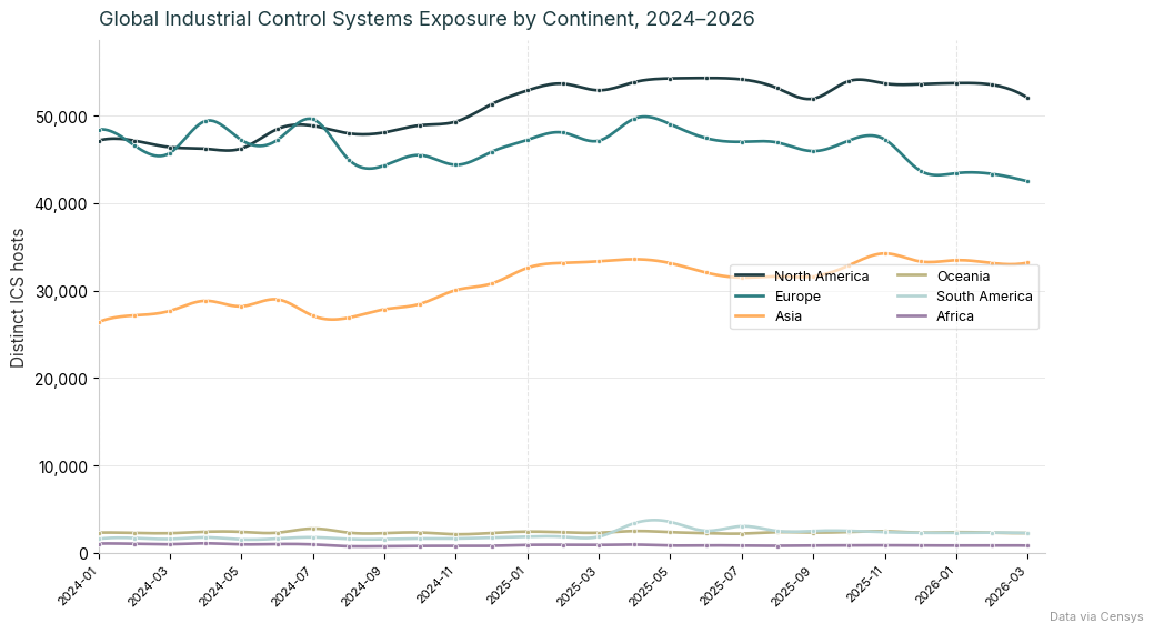

Global ICS Exposure Is Growing and Shifting
Censys observes an average of 134,000 distinct hosts running ICS services and tooling exposed on the Internet in early 2026, up roughly 4% from about 129,000 in 2024.
North America Accounts for 38% of Global ICS Exposure
North America has more ICS exposures than any other region, accounting for more than 38% of all global ICS exposures.

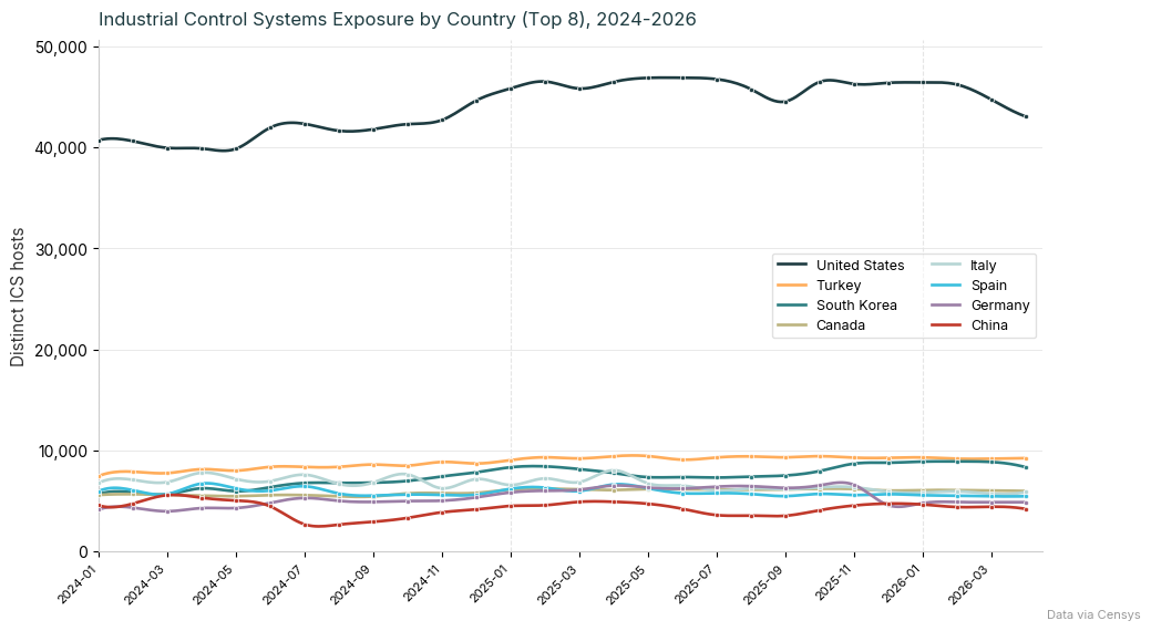

The United States Has Roughly as Many ICS Exposures as All of Europe
The United States accounts for 32% of global ICS exposure on its own, with over 40,000 exposed hosts, which is roughly the same share now held by the entire European region combined.
Turkey ranks second globally with fewer than 10,000 exposed hosts. The US total is more than four times larger.
Europe’s Share of Global ICS Exposure Is Declining
Europe fell from 36.5% of the global total in 2024 to 32% in early 2026, with France, Italy, and Belgium together accounting for approximately 85% of that decline.
Europe’s regulatory and commercial environment differs from other regions, including evolving cybersecurity requirements such as NIS2, which may be one factor contributing to this shift. The data alone, however, does not establish causation. Europe’s declining ICS exposure is a bright spot and raises interesting questions about what may be driving this progress and whether it can be replicated elsewhere in Europe and around the world.
