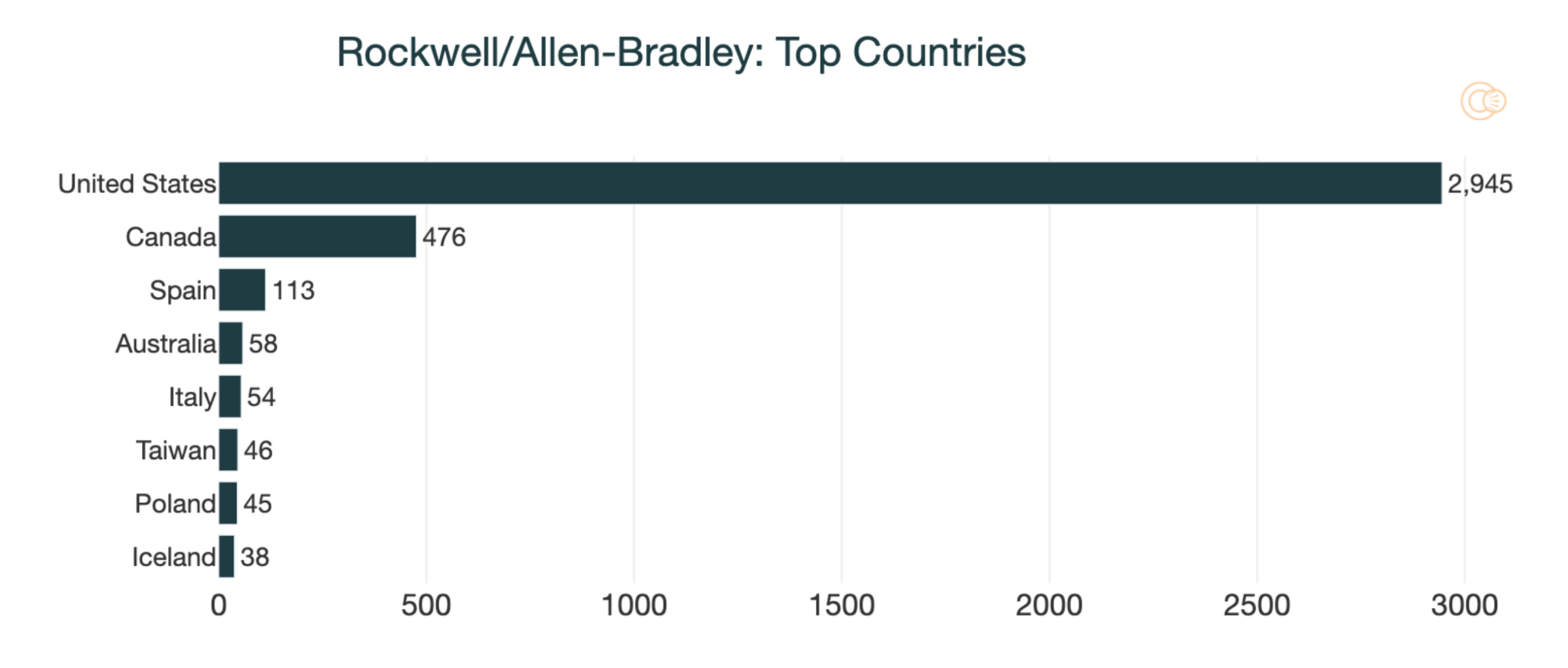

Rockwell/Allen-Bradley Ethernet/IP
Censys ARC identified 4,148 Internet-exposed hosts that respond to EtherNet/IP and self-identify as Rockwell Automation/Allen-Bradley. The United States remains dominant at 71.0% (2,945 hosts), with Canada a clear second at 11.5% (476 hosts).
Geographic Distribution
Rockwell/Allen-Bradley EtherNet/IP exposure by country (Censys, 2026-07-30)

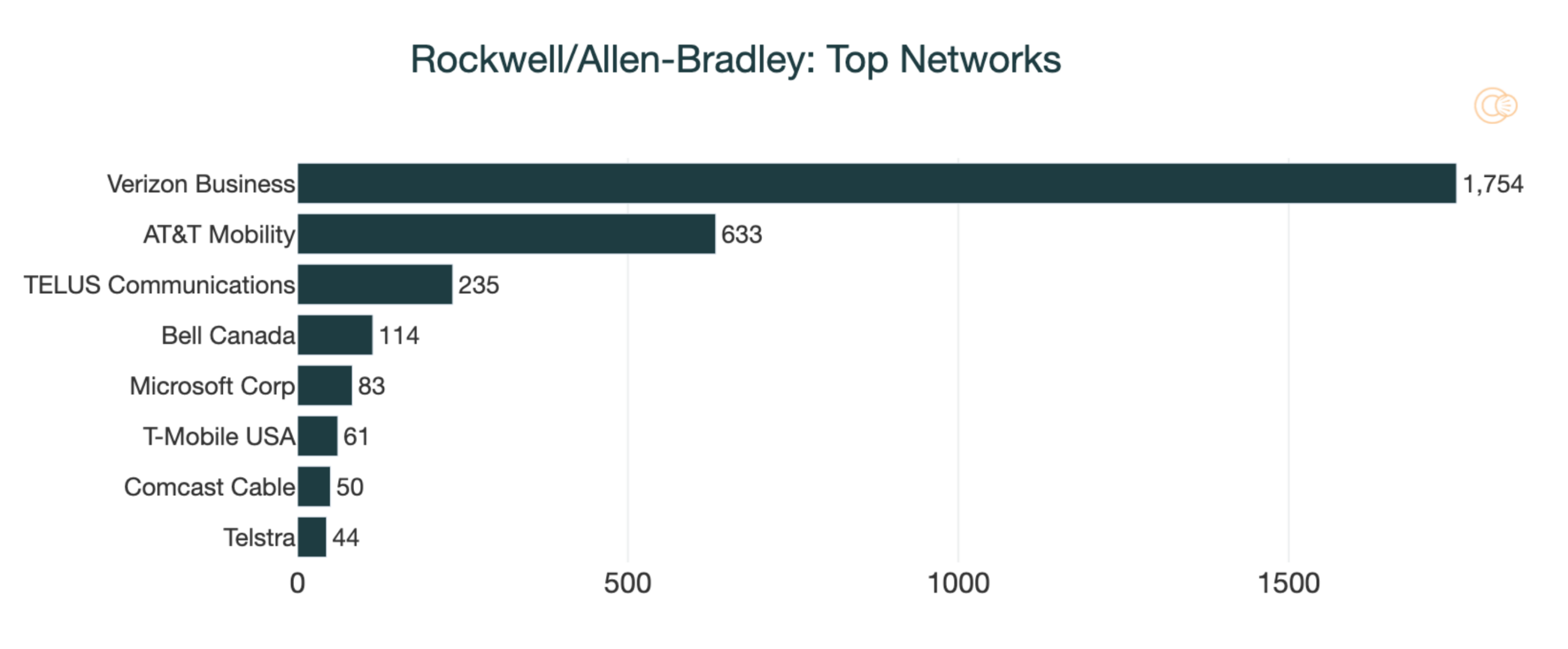

Network/ASN Distribution
Rockwell/Allen-Bradley EtherNet/IP exposure by network/ASN (Censys, 2026-07-30).
Combined cellular carriers (Verizon Business, AT&T Mobility, T-Mobile USA) account for 59.0% of all exposed hosts.

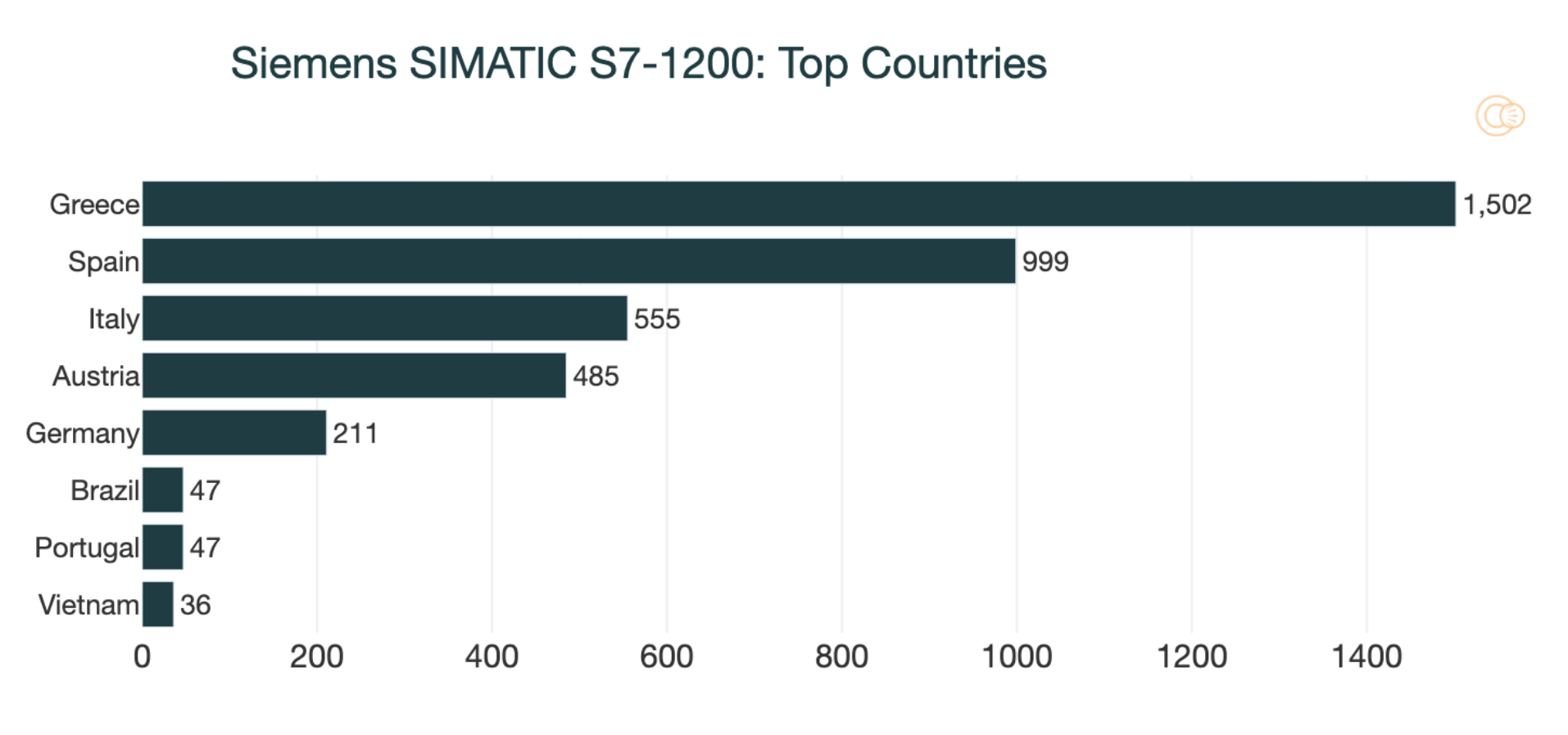

Siemens Simatic S7-1200
Censys ARC identified 4,117 Internet-exposed hosts that fingerprint as Siemens SIMATIC S7-1200. Exposure concentrates heavily in southern and central Europe: Greece, Spain, Italy, and Austria together account for 86.0% of the total, each dominated by that country’s leading mobile carrier rather than fixed-line or hosting providers.
Siemens SIMATIC S7-1200 exposure by country (Censys, 2026-07-30).

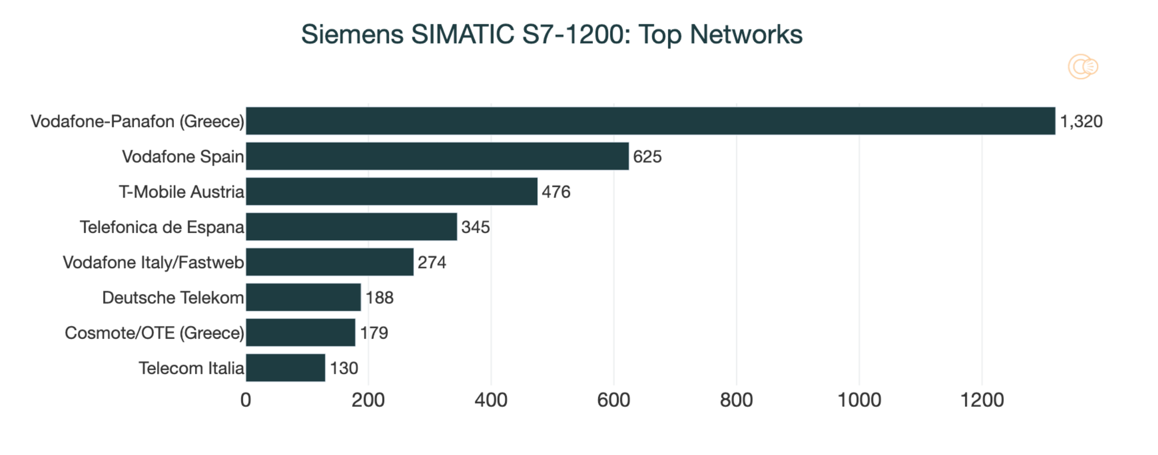

Network / ASN Distribution

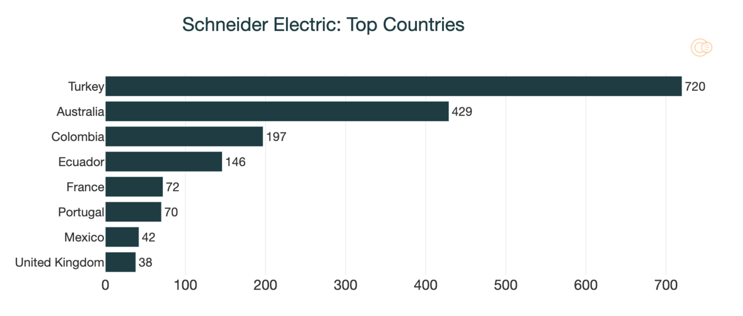

Schneider Electric (Vendor-Wide)
2,072 internet-exposed hosts fingerprint as Schneider Electric hardware (snapshot 2026-07-30). This query has no PLC-model or protocol filter. This total should not be read as Schneider Electric PLC exposure specifically. Turkey and Australia account for 55.5% of the total combined.
Schneider Electric (Vendor-Wide) exposure by country (Censys, 2026-07-30).

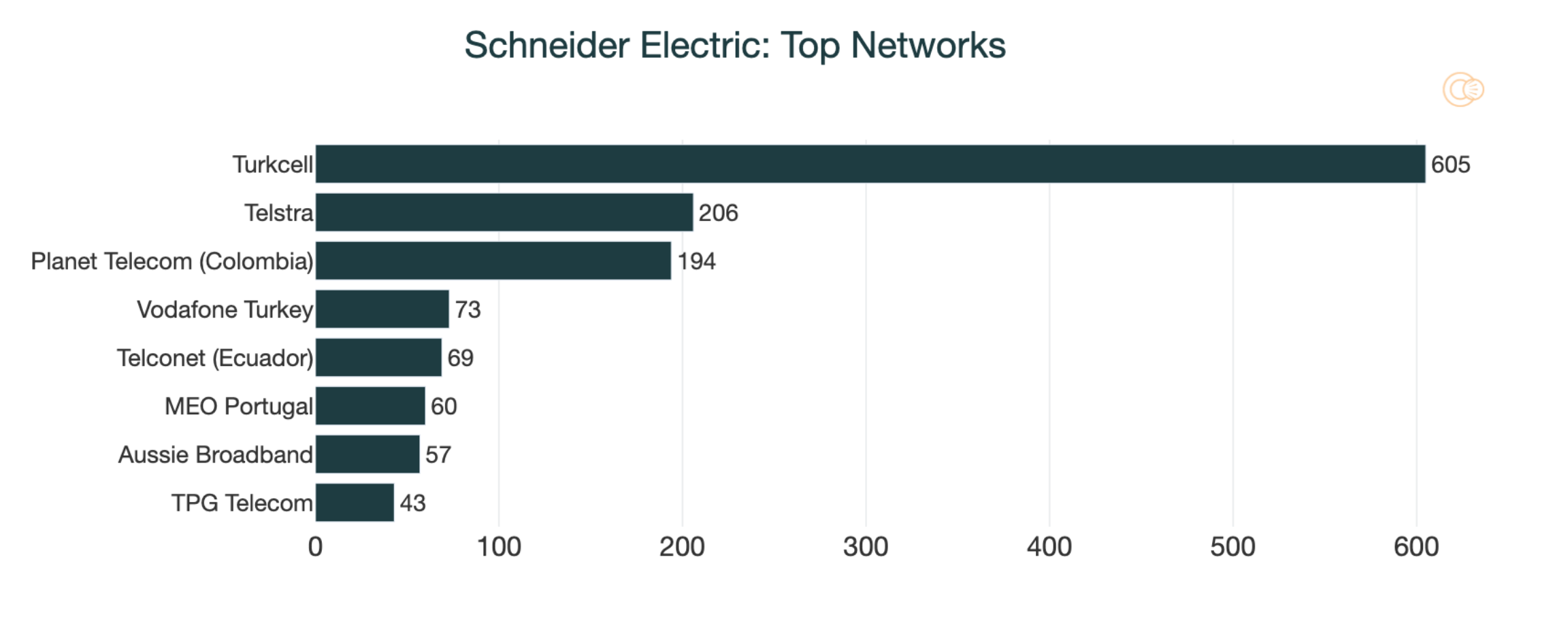

Schneider Electric (Vendor-Wide) exposure by network/ASN (Censys, 2026-07-30).
