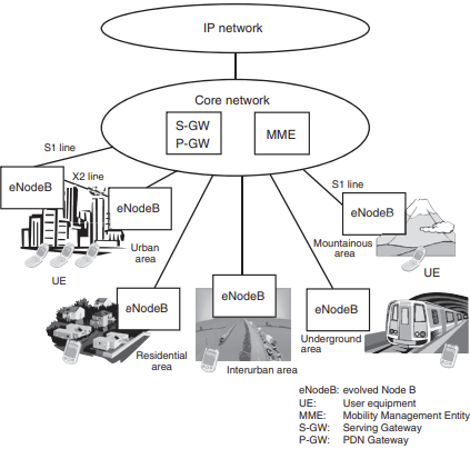

Typical LTE Network Architecture (via Fujitsu)

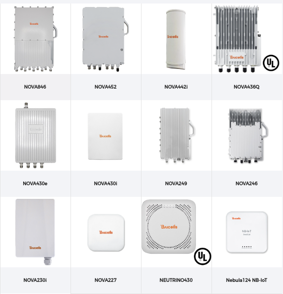

Baicells operates in a specialized corner of the telecom industry, focusing on hardware bridging mobile networks (e.g., LTE and 5G) and IP networks. Their eNB (eNodeB) products, for instance, connect to networks that interact with physical devices like phones while being managed through IP-based systems. Their equipment spans a wide range of use cases and price points, from rugged outdoor LTE to SOHO 5G routers.
Since Baicells devices exist within such a critical intersection of network infrastructure, the security of such a device is of the utmost importance; the possibility and probability of compromise should not be taken lightly, especially given that these devices are known to be running within the US government and military-owned properties.

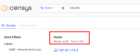

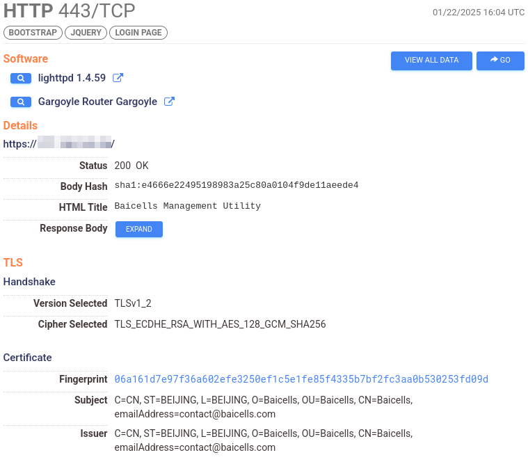

We began with a simple wildcard search for “Baicells” using Censys. This revealed numerous Baicells-specific assets, such as web servers with certificates referencingBaicells” and HTML titles like “Baicells Management Utility.
While this confirmed the presence of these devices online, further investigation was needed to determine their model and firmware versions, which are two critical pieces of information we would need to determine whether these devices were vulnerable to the two CVEs in question.

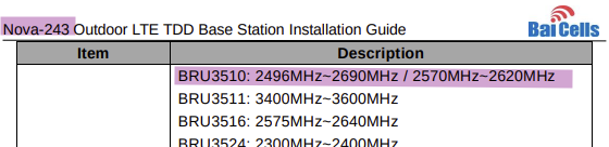

We noticed that a subset of the results we found in our initial search included what looked like a model name in the HTTP response body defined in a javascript variable—for example: “moduletype=’BRU3510′;”
When we looked for some of these supposed model names in a web search, we found a handful of technical documents related to Baicells, including explicit wording related to the Baicells Nova LTE basestations.
We found that the web interfaces we had discovered with this information were all related to the Nova (RTS) brand of Baicells devices potentially vulnerable to CVE-2023-24508. Below is a table of the known Nova devices, followed by the known Censys search terms that we used to identify a subset of those. Note that any of the model names that we exclude from the searches were not found within our dataset.

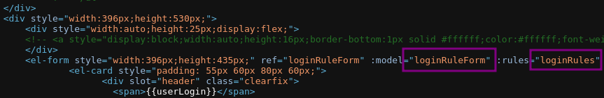

By examining the files served by the public-facing webserver, we identified unique fields within the HTML that could distinguish Baicells devices from non-QTRB-derived ones. Specifically, the file “www/pages/index.html” contained two distinctive form field identifiers: “loginRuleForm” and “loginRules”.
This allowed us to create a simple Censys search query tailored to these criteria, giving us a foundation for future queries targeting QTRB devices. At the time of our initial report to Reuters, this matched over ninety hosts.

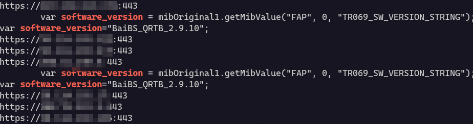

The most noteworthy file referencing a version was “www/pages/cgi-bin/overview.htm”, which extracted both “software_version” and “hardware_version” values from the underlying system and rendered them for the client. As shown in the screenshot below, this process is a series of system commands, with their output assigned to JavaScript variables.
Next, we combined the Censys CLI with the HTTP client “curl” to confirm that these endpoints do indeed render the software (firmware) version to the user. Using Censys, we identified hosts and ports matching the previously mentioned search criteria, then piped the host information to curl to request the path “/cgi-bin/overview.htm”.
In the command above, we included a grep to filter the output, ensuring that only hosts containing the specified variable were displayed. As shown in the screenshot below, this method enabled us to extract the specific firmware version running on a substantial number of these hosts—a critical piece of information needed to assess whether these devices were vulnerable to the CVE in question.
During our analysis, we identified 28 hosts that responded with this data and were confirmed to be running a vulnerable version of the QRTB firmware. Still, there were likely more out there that did not respond at the time.

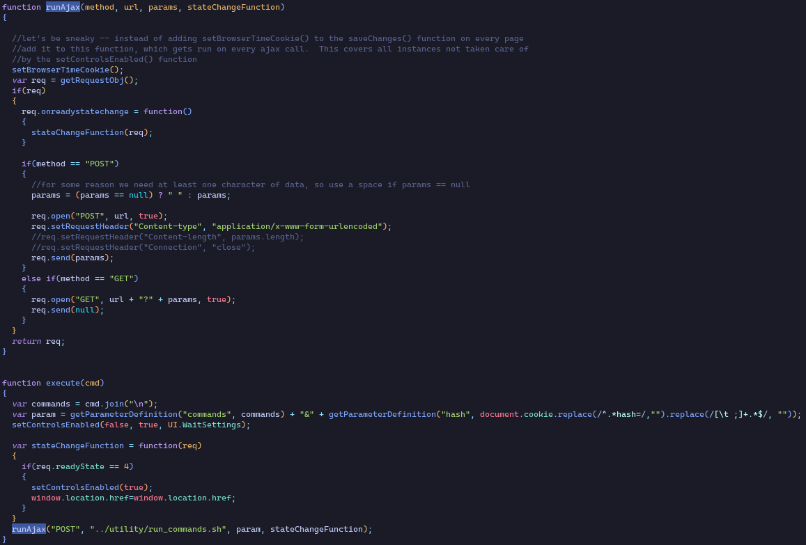

The purpose of these JavaScript files is to handle the form inputs generated by the CGI scripts and perform backend AJAX calls to other subsystems. These calls are made using the “runAjax()” function, which is defined in the “www-nui/js/common.js” file.
One of the most common methods of calling this function is to initiate an AJAX call out to the file “../utility/run_commands.sh” (which is also publicly accessible since AJAX is initiated on the client side)
The contents of the “run_commands.sh” file reveal another Haserl script with some alarming functionality:
Here, the “$FORM_commands” variable, derived from an HTTP POST request, is directly written to a temporary shell script (“/tmp/tmp.sh”) and executed using the “sh” command. Notably, in the vulnerable version of this firmware, the “baicells_session_validator” command is commented out, effectively bypassing session validation. As a result, simply requesting this specific file could lead to arbitrary code execution with ease.

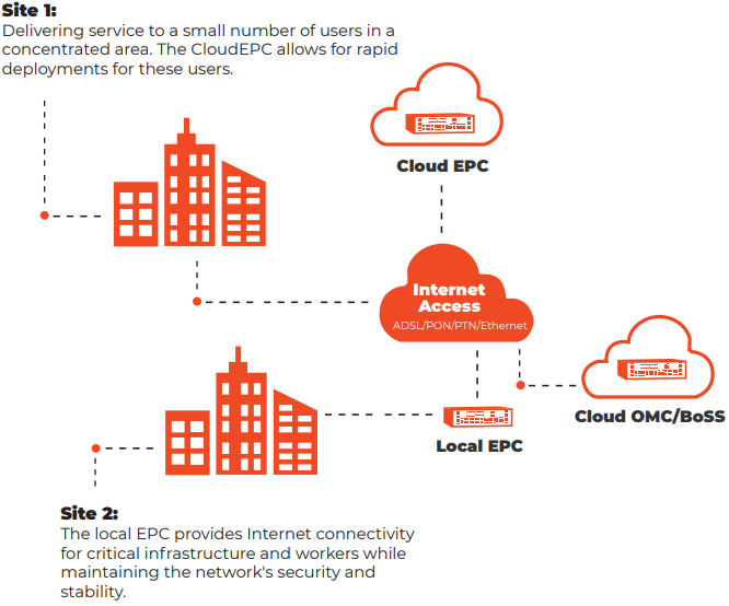

The hostname “west/east EPC” may be in reference to the telecom term “Evolved Packet Core” given the fact that Baicells offers a service called “CloudEPC”, a SaaS service provided by Baicells for deploying an EPC in the cloud and using their servers for handling the various functions of an LTE network such as the routing of data between physical devices like phones, and external networks like the internet.
CloudEPC overview (Via Baicells)

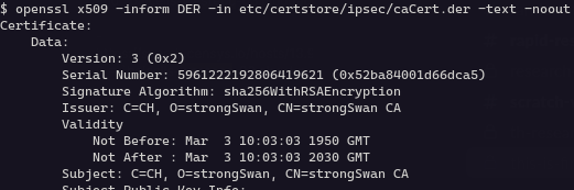

We can see these configurations in the QTRB firmware in two XML files that are eventually converted to legitimate StrongSwan VPN configurations via various provisioning and init scripts.
We should note that there is no evidence that these configurations are enabled by default; but, it seems that everything is in place for these VPNs to be enabled, including a readily available client certificate:

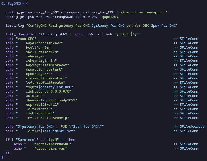

This configuration is seemingly loaded via an init.d script in “/etc/rc.d/S74ipsec” which is a symlink to “/etc/init.d/ipsec’. If we look at the “start()” function we see that there are several steps it goes through to eventually enable this VPN:
Here, the “CheckInstallation” function ensures that the “/usr/sbin/ip” tool is available on the system, then “config_load ipsec” is a wrapper around “uci_load” that reads in the configuration from “/etc/config/ipsec”. Then, “PrepareEnvironment” generates a basic StrongSwan configuration file into “/var/ipsec/ipsec.conf”. Finally, the “ConfigVpn” function is called, and it is defined as follows:
While the “config_get_bool” will be true since the default configuration for “strongswan” (in “/etc/config/ipsec”) is “enabled ‘1’”.  And for each configured tunnel in that configuration, “ConfigTunnel” generates a valid StrongSwan configuration. However, right before this happens, we see a call to a function named “ConfigOMC”.
This “ConfigOMC” function is odd because it statically configures another VPN tunnel to a  remote endpoint with the hostname “baiomc.chinacloudapp.cn” – a host which currently resolves to the IP 42.159.86.204 – a server located in Beijing, China:

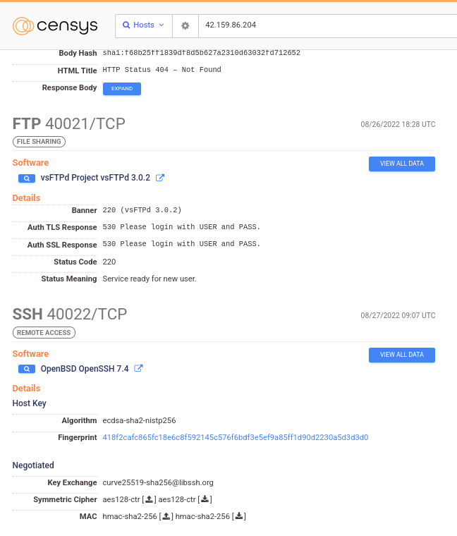

42.159.86.204 has seen its fair share of interesting services over the years, including SSH and FTP servers on very high ports and web servers that go up and down over time with Baicells certificates, which provides evidence that these hosts were actively used up to May 1st, 2024 when the host last saw a running service.

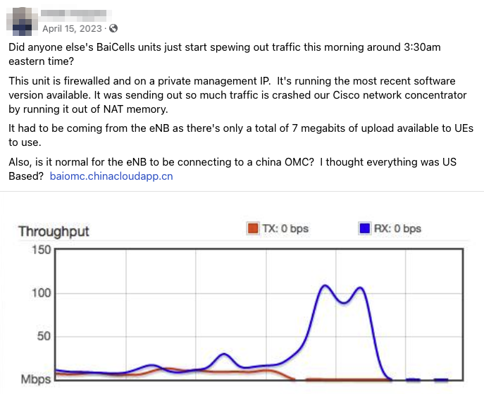

There have even been unsubstantiated claims on an unofficial Facebook forum about Baicells that have stated they saw sudden unwanted increases of traffic going to “baiomc.chinacloudapp.cn” back in 2023. A post that can be found with a simple Google search.
