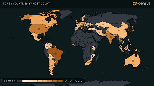

Top 50 countries by host count exposing Boa (Censys)
Past the production line, it falls on consumers to ensure underlying components are being secured via firmware. Under such circumstances, consumers are often left vulnerable and dependent on a system’s update cycle. If a company neglects its firmware maintenance, consumers are forced to become unwilling participants for hosting insecure software and can only rectify the situation by purchasing a new system.

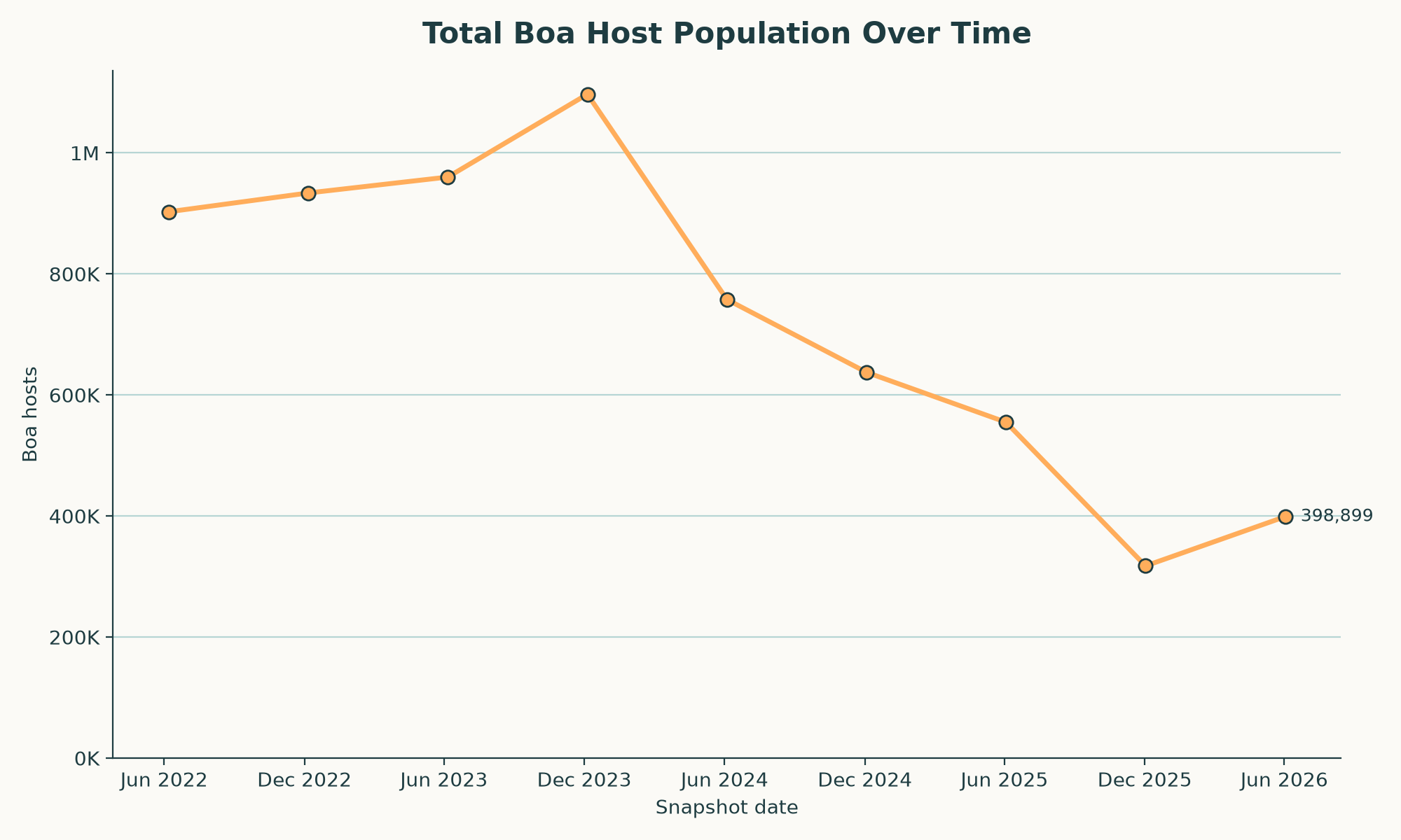

Although a gradual transition away from Boa has been observed within the last few years, the service still retains a significant footprint on the Internet, leaving many devices vulnerable to botnet exploits and Mirai heirs.
Historical snapshot of Boa Host count in Censys’ Database.

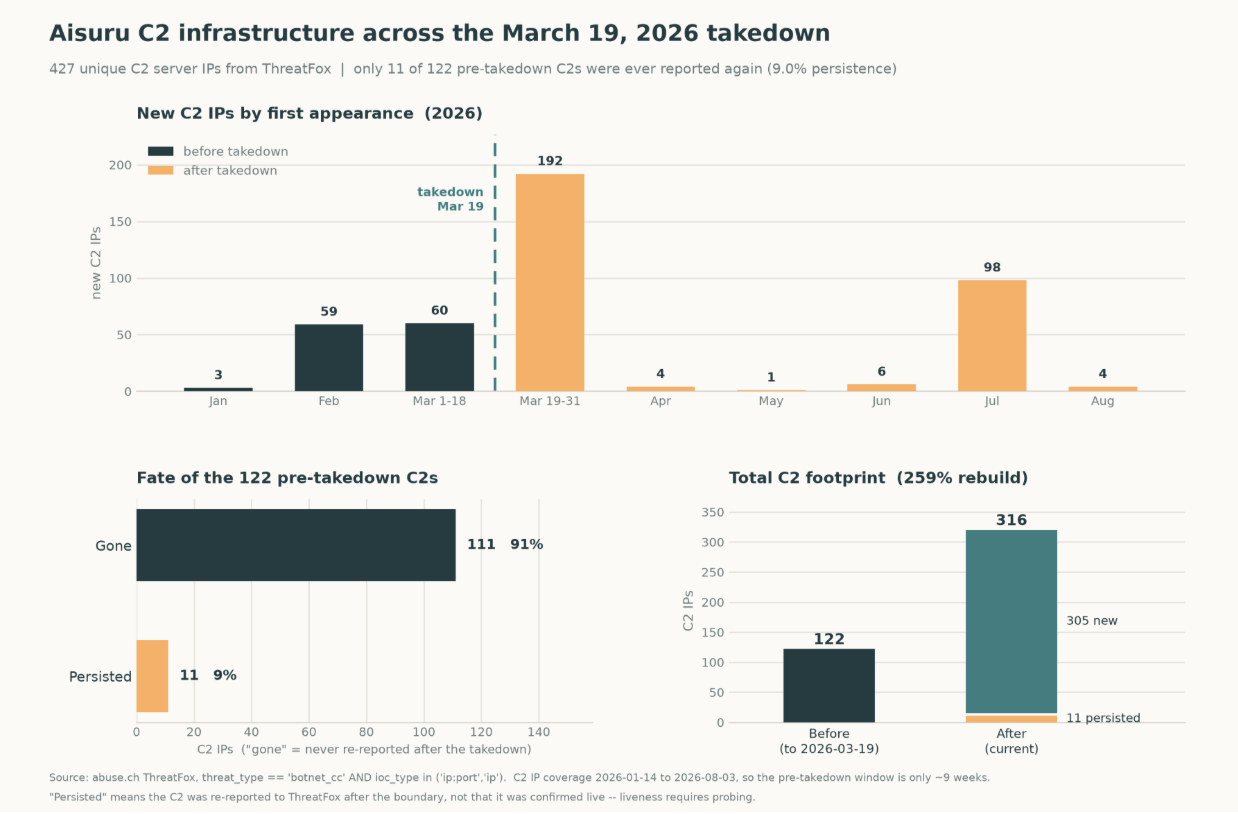

Aisuru’s Rapid Recovery and Growth
When analyzing the persistence of known Aisuru C2 servers reported on ThreatFox, a public threat-intelligence database, 9% of reported C2 IPs persisted past the FBI’s March 2026 takedown. Although the takedown produced an immediate reduction in active Aisuru C2 servers, within four months the total infrastructure of known Aisuru servers had more than doubled relative to its pre-takedown size.
Note that ThreatFox is a public, community-submitted dataset, so this figure should be read directionally rather than as a precise count. Public feeds are susceptible to false positives and detection bias, and growth in reported infrastructure isn’t identical to growth in actual infrastructure.
Still, this pattern is consistent with independent reporting on Aisuru’s growth. So long as the botnet has access to a pool of unpatched devices to recruit, it will continue to be a public threat. If the exploitable vulnerabilities that built a botnet in the first place are never addressed at the source, its infrastructure may regenerate, and potentially exceed, its original size once enforcement pressure lifts.

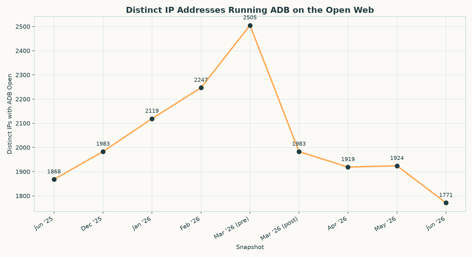

This story is reflected in Censys Internet scan data tracking exposed Android Debug Bridge (ADB) services over the past year. Kimwolf specifically targets devices exposing ADB on its default ports, 5555 or 5037, which makes those ports a useful lens for measuring the botnet’s available attack surface. Most ADB systems were never designed to be exposed in the open Internet, and devices that retain manufacturer-default credentials after being exposed become immediate targets for Kimwolf’s scanners.
Over 90% of ADB services observed by Censys were running on these default ports. It’s worth noting that reachability alone does not confirm whether authentication is disabled on each device.
Tracking the size of this exposed population over the past year shows a gradual increase, followed by a steep decline of over 500 hosts immediately after the March 2026 takedown. In recent months, however, the total number of exposed devices has returned to nearly the same level it was at a year before the takedown.
Historical snapshot of ADB Services Exposed on the Internet (Censys). The takedown itself occurred on March 19, 2026, with pre and post taken the week before and after.

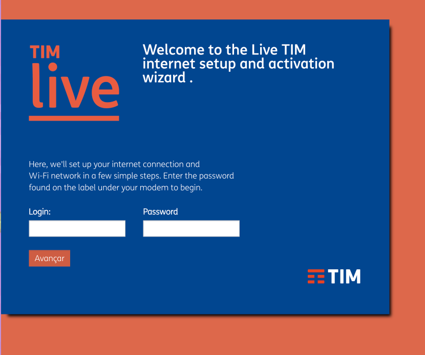

Among cybersecurity practitioners, leaving a router on its default credentials reads as an obvious mistake. But most of the general public isn’t trained on what a router does or how to configure one, and manufacturers often market these devices as “plug and play,” reinforcing the assumption that a working connection means a secure one. Genuine security hygiene requires changing default credentials and configurations at setup, but many users never do, either because they don’t know how, or because a functioning Internet connection feels like confirmation that nothing needs to change. Additionally, maintenance adds to the problem. It is not unusual for users to be frequently behind on updates, leaving routers running unpatched or end-of-life software. Even when routers are compromised, users often have no way of noticing unless it affects their Internet connection.
Router marketing built around a three-step “plug and play” promise.

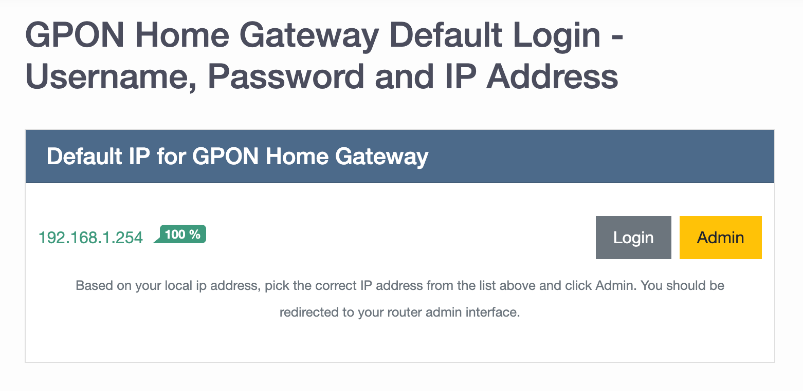

The result is a large, persistently exploitable population of devices. GPON routers are a clear illustration of how visible that population can be. The acronym GPON stands for Gigabit Passive Optical Network which is “fiber access technology for delivering gigabit Internet services to residential and business subscribers” as described by Calix. GPON routers are not inherently less secure than other router types, though they have been targeted by Mirai and related botnets due to known vulnerabilities in their firmware. What makes them a useful case study is visibility: because GPON login interfaces use a distinctive name and interface, they’re easy to identify at scale. Over 120,000 GPON hardware vendor web services are currently visible on the open web.
What’s concerning is that Censys observed 117,000 of these exposing GPON Home Gateway login pages, many bearing default HTML titles (“GPON Home Gateway”) that are associated with a model commonly deployed in residential networks. These login portals exist so new users can configure a router upon first connecting and are not meant to remain reachable from the public Internet after setup.
Such a high volume suggests that a large share of users are leaving their routers on factory-default settings or failing to restrict access to the login page after setup. When a router is left on default credentials and publicly reachable, anyone, including automated botnet scanners, can locate its login page and authenticate using nothing more than the manufacturer’s default username and password. This figure suggests that non-enterprise environments make up the population most exposed to these login-page misconfigurations.
A typical ISP setup wizard.
A third-party lookup site listing default GPON gateway IPs and admin logins.

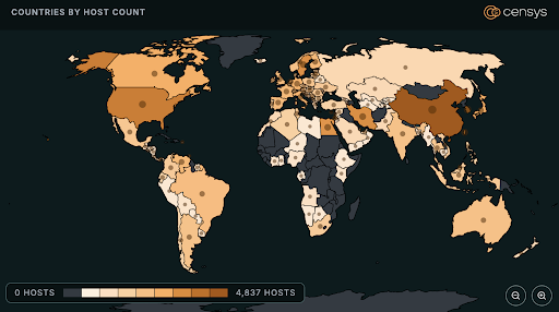

Countries by host count for Internet-facing IoT devices with UPnP enabled and multiple ports accessible (Censys).
