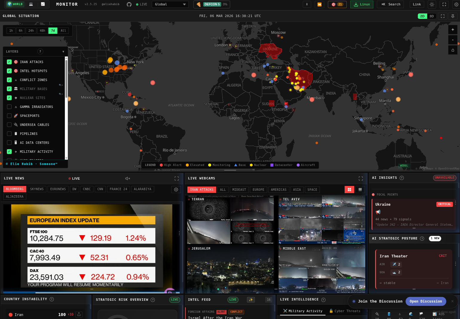

The use of open cameras for situational awareness extends beyond traditional applications. For example, Live Webcams were recently integrated into the widely used World Monitor app, as shown below.
Dashboard of many different camera feeds and intel feeds throughout the Middle East and Eastern Europe
Word Monitor showing Live commercial available live camera feeds

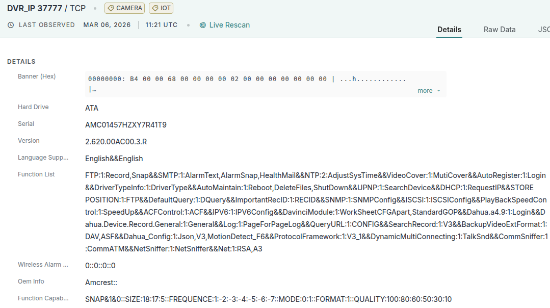

As an example of how the Censys research team approaches discovering these cameras, let’s consider CVE-2020-5735, a vulnerability affecting certain Amcrest cameras and network video recorders (NVRs). The vulnerability allows an authenticated remote attacker to trigger a stack-based buffer overflow on port 37777, potentially crashing the device or executing arbitrary code.
Because the advisory references both a specific vendor and network port, this information can be used to identify potentially affected devices on the internet using Censys. Below, we construct a query to locate hosts that expose port 37777 and whose service banner contains the string “Amcrest”.
host.services: (port=37777 and "Amcrest")
At the time of writing, the above Amcrest query returned 1,393 results, with all but two services listening on port 37777 identified as running the DVR/IP protocol, which is widely used by Amcrest surveillance devices.
Although this vulnerability requires authentication, obtaining credentials may not be as difficult as it sounds. A simple web search for “Amcrest default username and password” quickly leads to the official Amcrest documentation for accessing the device’s web interface, which states:
“If this is the first time accessing the device, the username and password will both be admin
Therefore, when default credentials remain unchanged, which is frequently the case, the barrier to entry for attackers seeking to compromise or exploit the camera is significantly reduced.
